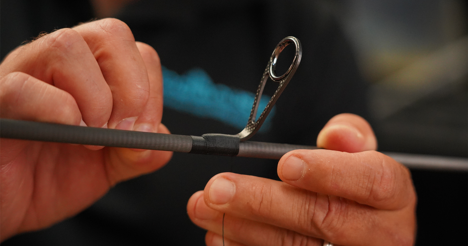

2. Wrapping the Guides: A Precise Step
Guide wrapping is a crucial precision task that requires patience.

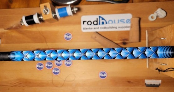

  • Wrapping a complete guide set (7-9 guides) with basic black thread:
    • Experienced builders 🎯: 30 minutes
    • Beginners 🏗️: Take your time and work step by step.
✅ Pro Tip:
If you're new to rod building, start by wrapping two guides per evening and progress gradually. By the weekend, you’ll be ready for the varnishing stage.
💡 For powerful rods: These take longer since underwraps are required for reinforcement.
