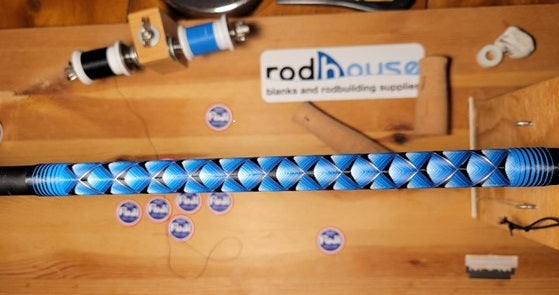

The chosen pattern is the “Fish Scale”. For this type of wrap:
  • On one axis, start by drawing a full motif on the butt side.
  • On the opposite axis (180°), start with a half motif.
  • Each pattern consists of three scales, so each section is divided into three.
Fish Scale Wrap Diagram
Step 1: Creating the Base
Before starting the wrap, apply:
  • About ten rounds of tape at the butt side and after the PM to protect the blank.
  • A layer of double-sided tape over these protections.
Step 2: Starting the Wrap
Begin by:
  • Wrapping two turns of black thread on the double-sided tape at the butt side.
  • Continuing at a 45° angle along the traced axes.
  • Making 1 or 2 turns at the tip side, then returning by crossing the threads.
Starting the Wrap
Step 3: Second Pass
Add a pass with light blue thread on the butt side.
Important: Keep the thread tight so it stays aligned with the black thread.
Step 4: Third and Fourth Passes
  • 3rd pass: Add a black thread on the tip side.
  • 4th pass: Add 2 blue threads next to the first blue thread.
Step 5: Continuing the Passes
Keep alternating colors:
  • 5th pass: 1 black thread
  • 6th pass: 2 blue threads
  • 8th pass: 3 blue threads
  • 12th pass: 4 blue threads
  • 16th pass: 5 blue threads
  • 20th pass: 6 blue threads
Advanced Wrap
Step 6: Finishing and Varnishing
Once the wrap is complete:
  • Apply 2 coats of color preserver.
  • Let it dry for 24 hours.
  • Apply 2 coats of varnish.
Tips:
  • Use a magnifying glass to check details.
  • Ensure threads are tightly packed after each pass.
Varnishing
Your “Fish Scale” wrap is now complete! 🎣
