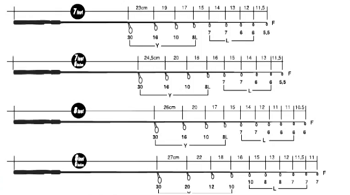

The easiest way for a first rod is to follow Fuji's specifications. They will tell you the number of rings to place on your rod, their size and the spacing to allow.
Find the Fuji specification at this address: Fuji specification
How a Fuji specification looks
For a 7-foot (2m13) blank, you choose the most suitable specification based on the length. For example, at 11 cm from the tip, you'll place a size 6 ring, at 12 cm a size 8 ring, and so on.
For your first rod, it's really worth following these specifications. They are proven, reliable and give very good results.
How to place your rings
Following the specifications, use a white pencil to mark your measurements. The white marks will indicate where you will install your rings, which you will then Wrapping in that location.
