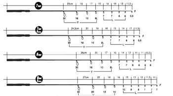

Ring size
Before getting started, the first step is to prepare your ring by filing it so that the wire can ride well on it when tying. File the ring leg roughly enough to scratch it and allow the wire to adhere well.
Once you've traced the location on your blank, you can place your ring.
