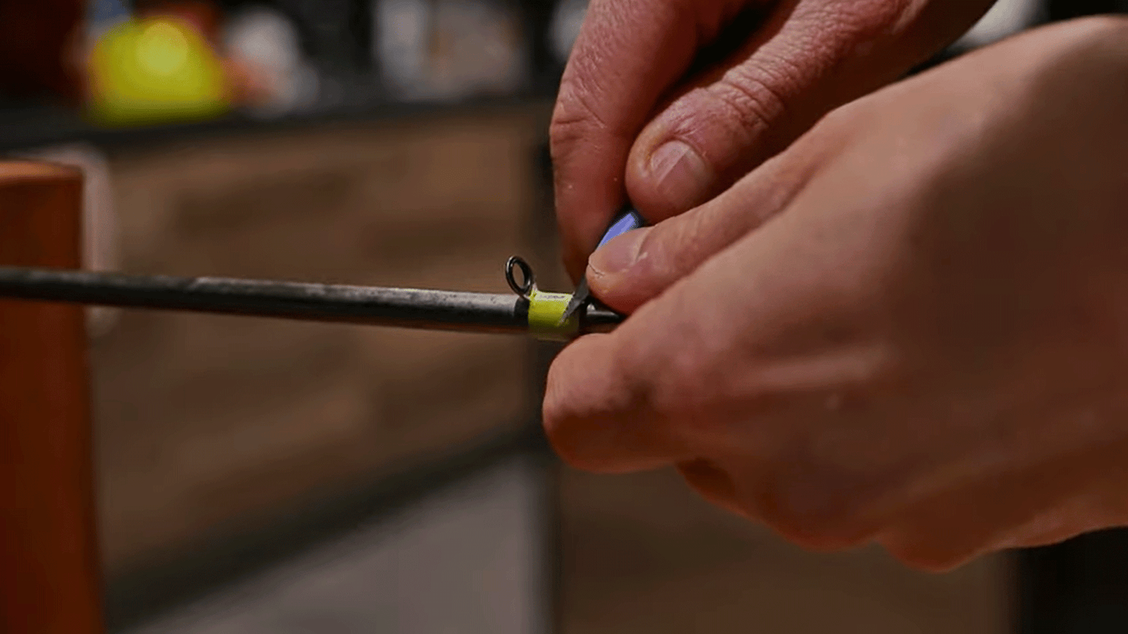

The pro-staff's tip: "If I had to choose just one tool for this operation, it would be a new cutter blade!"
The aim is to make a cut on the top of the ring leg to eliminate the risk of touching the blank. Be careful about the direction of the cut: you go from the tip of the ring lug towards the ceramic. If the blade rips, it will be stopped by the ring! [caption id="attachment_855" align="aligncenter" width="800"] The cutter blade comes OVER the ring lug and up towards the ceramic. Do not go underneath![/caption] [caption id="attachment_845" align="aligncenter" width="800"] Push down and scrape up to the ring lug[/caption]
Pro-staff tip: To avoid blade ''slippage'', one hand holds the cutter and the thumb of the other hand pushes the blade, this allows you to perfectly manage the pressure on the blade!
[caption id="attachment_846" align="aligncenter" width="800"] Most of the work is done. Then it's just a matter of removing the ring[/caption]. [caption id="attachment_848" align="aligncenter" width="800"] When the ring is removed, what remains is a "varnish + thread" shell that is very easy to remove.[/caption] [caption id="attachment_849" align="aligncenter" width="800"] There's usually a little varnish left on the bottom of the Wrapping. The principle is to pull on the remaining wire[/caption]. [caption id="attachment_850" align="aligncenter" width="600"] Small traces of varnish will remain on the blank, which can be scraped off with the non-sharp side of the blade.[/caption] The tip ring is usually glued on. Once you've removed the varnish and Wrapping, bring along a pair of tweezers and a lighter. Quickly heat and rotate the ring, then remove it.
