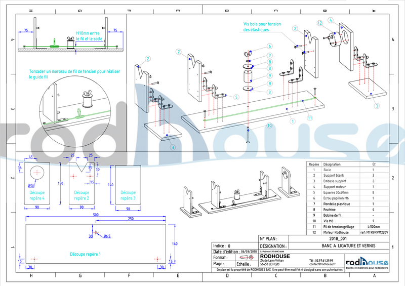

Building your own rod wrapping jig: a step by step plan
Building a rod wrapping jig takes little more than a board, a few brackets and some felt. Here is the build plan, the tension setting and the limits of the home made version.
The blank and assembly that suit each fish, with feedback from our rodbuilders.
