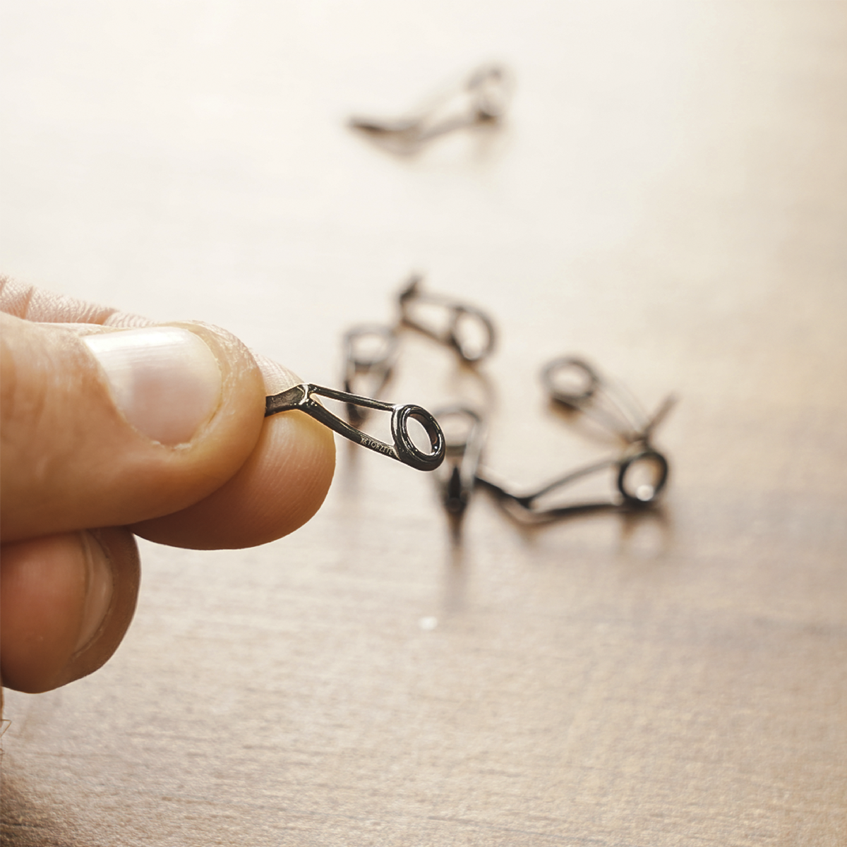

On a rod, the guide is the component you choose last, even though it decides your casting distance, the sharpness of your feedback and how long your line survives. Two pieces make it up: the ceramic the line runs on, and the metal frame that holds it. You choose them separately, and you can get either one wrong.
Fazlite, Alconite, SiC, Torzite on the fishing rod guide ceramic side; stainless, titanium, carbon on the frame side. This guide compares what can be measured, hardness, weight, thermal conductivity and salt resistance, then tells you which combination goes with which style of fishing. If your problem is a guide that is already broken rather than a build decision, our guide replacement tutorial covers it step by step.
A guide does more than hold the line along the blank. It guides the line, spreads the load of the fight across the structure, controls friction on the cast and sheds the heat produced when line runs out under drag pressure. That last role is the one most often forgotten: on a fast run, the temperature at the contact point climbs very quickly, and it is the line that pays.
These functions do not fall to the same part. The ceramic manages glide, friction and heat; the frame manages stiffness, load transfer and salt resistance. One more parameter is often forgotten: the further a guide sits from the reel seat, the more its mass weighs on the blank's action and damps its resonance. A gram saved at the tip is worth several grams saved at the butt.
