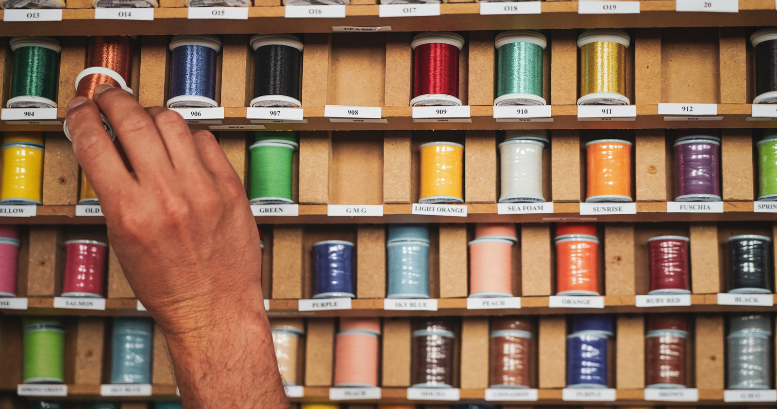

Color Concordance Chart
The tables below show the color matching of Fuji/ ProWrap nylon and Metallic wires to rings, grips and blanks.
In each row, the wire number closest to the ring/grip/blank is red. If the 2 wire numbers are the same color, there's virtually no difference between them.
