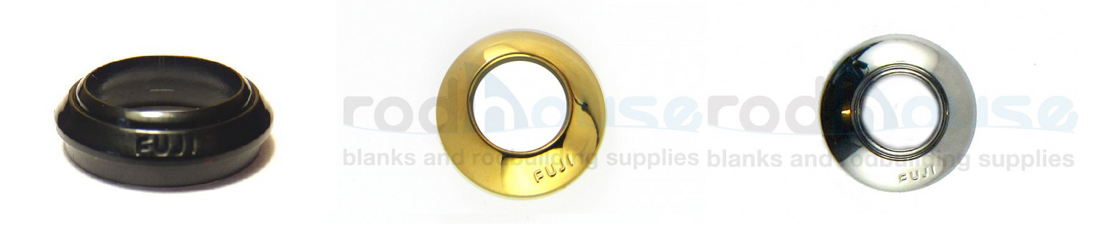

Finishments
The aficionados of the search for the smallest superfluous gram will also find here an ally of weight! A WCS size 16-10 weighs just 0.30gr... The funny thing is that normally, the lighter you make a part, the more expensive it is, but the opposite is true: the price of the ring is really derisory compared to the advantages it brings!
The other advantage of this ring is also that it has a tenon which will facilitate its holding and perfect centering in the reel seat thread during gluing. By the way, it is perfectly resistant to the rubbing alcohol used to clean glue residues. The tenon also allows you to use this ring to embellish a reel-holder grip or a butt, the only limit being your imagination.
Close-up of a WCS ring finishing a cane butt
In terms of color, it comes in a very sober gloss black that blends perfectly with all styles. But those who prefer a more sophisticated finish will be delighted, as it is also available in silver and gold.
In my opinion, it's practically the perfect ring (rhaaa!! If only there were a few more colors...) and I use it a lot, both to close Casting or Spinning reel seat threads, and to embellish/terminate a butt or carbon handle. Give it a try on your next rod, you won't regret it!
